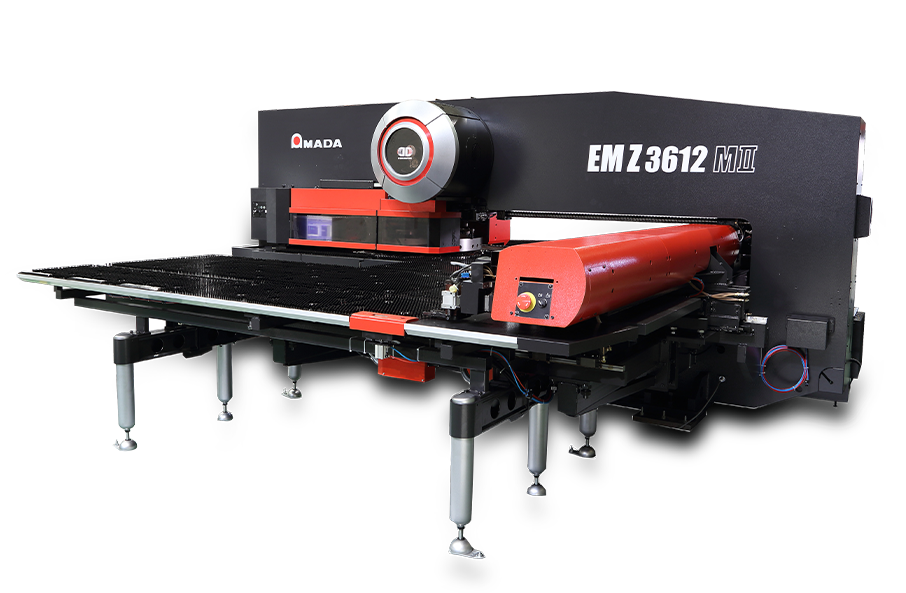

EMK M2 Series
Turret Punch Press
EMZ 3612 M2
  • EMK M2 series
unmatched performance, superior reliability, lower operating costs
The EMK M2 Series turret punch press uses twin AC servo drives directly coupled to the drive shaft. AMADA’s drive system combines the simplicity of the original clutch and brake technology with the high speeds of the fastest hydraulic ram driven systems. The result is unmatched performance, superior reliability, and lower operating costs.
EMK M2 Series Standard Features
  • Process 10'x5' sheets without repositioning (EMK 3612 M2 only).
  • The highest real-world hit rates and ram positioning accuracy.
  • Twin servo drives eliminate the need for complex hydraulics or oil-cooling chillers—dramatically reducing maintenance and repair costs over the life of the machine.
  • Precision ram motion control (speed, stroke length, hover height and hold time) helps reduce tooling wear and punching noise.
  • Electrical power savings of up to 70% over typical hydraulic machines.
  • Standard 58-station or 55-station, triple track, King turret. Both turret configurations include two 4½" and two 1¼" auto-index stations.
  • Extended tool life and minimum tool maintenance with Air Blow Oil Mist tooling
  • Virtually eliminates slug pulling with the power vacuum system
  • High quality, press-brake-like forming operations up to ½" with programmable dwell at bottom of stroke for complete plastic deformation
  • Progressive forms, flanges and embossments up to ½" eliminate secondary operations
  • Forming and high quality processing eliminate secondary operations
  • Reduced vibration of the direct twin drive ram combined with the rigid bridge frame ensures tighter tolerances extending tool and machine life while producing high quality, distortion free parts
  • Brush table design provides scratch-free processing, eliminating secondary finishing.
  • Free standing PC-based network CNC control allows for flexible layout
