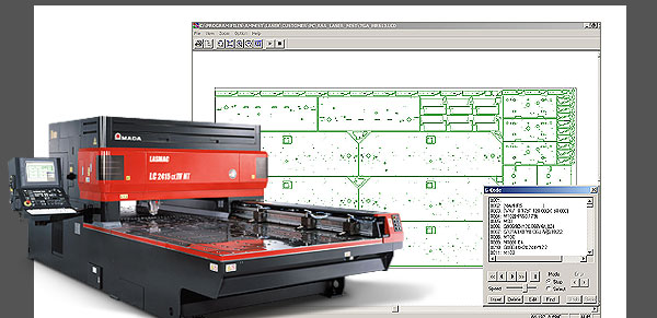

- DXF parts nesting with layer control as well as scrap and remnant cut options
- AP100 US/FabriWIN Part Support with ability to import and nest AP100US/FabriWIN .PRT part files
- DXF Analyzer to check DXF part geometry for complete, discrepant, or incomplete shapes, including the capability to laser tool fit single DXF parts, view laser sequence and create, simulate and edit G-code files
- Ability to output laser Pre-Cut for cutting condition inspection
- Hole Scrap Cut (cutout destruction) with DXF parts
- Supports scrap cut in X and Y directions as well as ending (remnant) cut for DXF parts. (Ability to output scrap cut before or after parts cut on the nested sheet for laser DXF nesting)
- Supports G121 laser edge detection parameter (A1 through A8), enabling return to Z height after edge detection and target corner X and Y offset
- Supports vertical ending cut with G-code parts (FO lasers)
- Option to display laser path direction in G-code simulation
- Ability to select different laser cutting start corners for nested sheet patterns
- Includes Enable Circular Parts logic to better nest circular shaped parts for increased sheet utilization
- Supports part rotation (Yes, No, 180) for grain direction purposes
- Ability to output laser cutting condition E number before every laser path
- Option to eliminate X or Y from nested laser program if the coordinate doesn’t change
