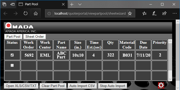

The Amada Part Pool is a part queue, where parts are waiting to be processed. It acts as a middleman between the user's MRP/ERP systems and the machines on the shop floor, making it easier for the user to create Part Schedules that can be pushed into nesting jobs. The Part Pool is designed to work with MRP/ERP systems directly or with Amada's Influent IIOT System.
By default this option is disabled. To activate this option the Part List Pool Mode checkbox in Settings>Advanced Settings must be checked ON. These other options in Advanced Settings must also be checked ON: Auto Commit to Schedule List, Ignore Sheet Available Quantity and Max Filler Parts for Part List Pool to function. If the option is checked OFF, auto-nesting with parts that are stored in the AP100US Part Pool will be disabled.
Function Buttons
Toggle between Part Pool and Sheet Order views.
Open XLS/CSV/TXT to browse to the location where these files are stored.
Select Clear Part Pool to remove all parts from pool. If part is removed from the Part Pool, it is still in the user's MRP/ERP system.
To Auto Import CSV, first select the   icon to configure import settings. Select the Upload Interval (this allows CSV files to be uploaded in intervals, rather than all at once), select the Directory where the CSV files are stored and then click OK.
After Auto Import CSV has been selected, hit Stop Auto Import to terminate the import process.
Load Parts into the Part Pool Database

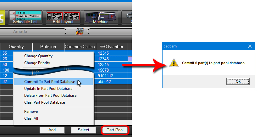

loading parts into the Part Pool database is done through the Sheet Wizard>Load Parts panel.
Load parts into the Sheet Wizard Parts List by clicking the Add button. When parts for a job have been loaded and configured, select a part or parts and right-click on the selected parts to display the flyout menu shown below. Select Commit To Part Pool Database to load the selected part(s) into the Part Pool.
The Part Pool contains a list of parts waiting to be nested. View this list by opening a web browser and navigating to this URL:
http://<server name>/quoterportal/viewpartpool/sheetwizard
<server name> should be the computer name or an IP address where the Part Pool resides. If the Part Pool is in the local computer, use localhost.
For more info on using the Part Pool, go to the AP100US-CIM User Guide.pdf stored in the C:\AP100US\Manual folder.

Part Pool Options
Commit to Part Pool Database - Select to commit a part to the database.
Update In Part Pool Database - Use this option to update a part in the database, that has had, for example, its quantity increased.
Delete from Part Pool Database - Delete a single part from the database. Parts in the MRP/ERP database will not be affected.
Clear Part Pool Database - Clear all parts from the database. Parts in the MRP/ERP database will not be affected.
See Part Pool for more info.
