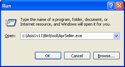

To find your license information and/or register an Amada product with the License Manager / AprSeller,
click theStart button - , open Run ,
enterc:\Asis1v11\Bin\tool\AprSeller.exein the Open field, and then clickOKto open the AprSeller dialog.

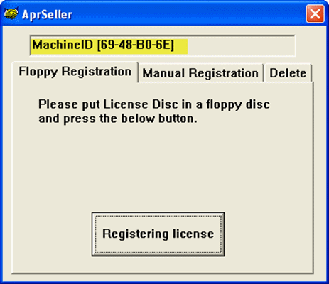

Mini SDD Environment
In a Mini SDD Environment, this window will open showing the Machine ID (highlighted in yellow).

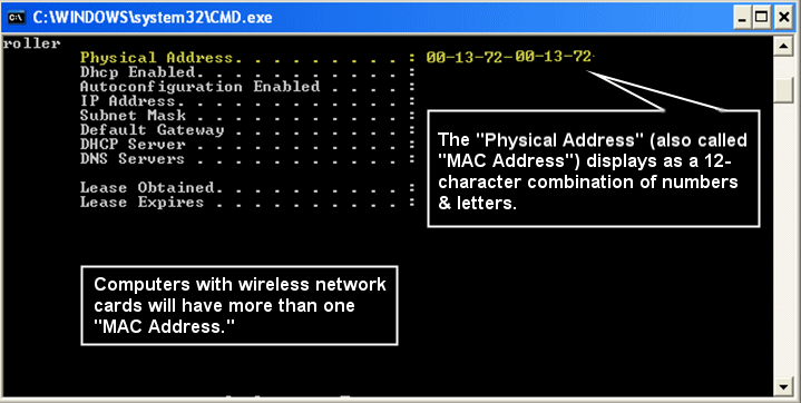

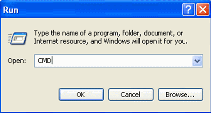

To find the MAC ID / Physical Address through the Command Prompt window
click the Start button - and open Run - .
In the Run dialog, enter CMD and click OK.
In Command Prompt type IPCONFIG/ALL in the window and hit Enter. Your MAC ID will display in the “roller” category as shown here -
