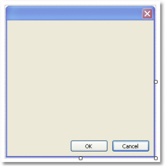

For adding a dialogue into a report, press the
button on the designer's toolbar. A
new dialogue looks as follows:

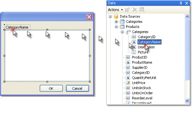

Filtering on related data column
As we know, between two data sources, a relation can be set. See more details in the "Data" chapter. With the help of relation, it is possible to filter data in the source, by using a data column from a different source.

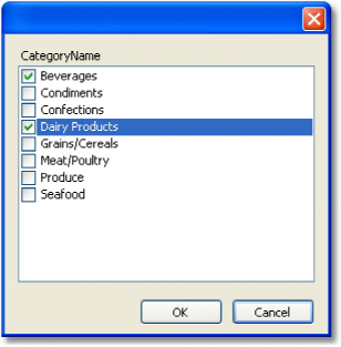

Assuming, you have placed on the dialogue a ListBoxControl and indicated the following data column in the "DataColumn" property:
Products.Categories.CategoryName
How will filtering work?
when filling the control with values, the "CategoryName" column from the "Categories" data source will be used;
the filter will be applied to the "Products" table. Those data rows will be filtered for which the following condition is correct:
the [Products.Categories.CategoryName] contains one of the values, selected by the user

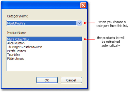

Filtering using cascading lists
A cascading list is a list with choices that change based on the value a user selects in another list. For example, you have two lists on a form - one with categories, another one with products. When you choose a category in the first list, you will see in the second list the products in a chosen category.
To create a cascading list, you need to use two data sources with master-detail relation between them (read more about data sources and relations in the "Data" chapter). Attach the master list to a column in the master data source; attach the detail list to a column in the detail data source. Also set the master list's "DetailControl" property to the detail list.

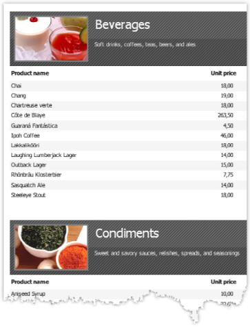

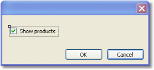

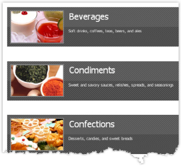

Example 4. Handling report objects

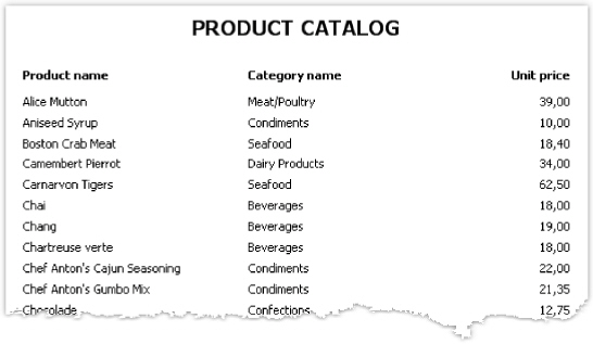

Let us look at an example of a report, which prints a list of categories and products in each category:
We will show how to stop printing products and print just categories, with the help of the dialogue. For this, add a dialogue into the report:
Double click on the "OcyrillicKacyrillic" button. FastReport creates an empty event handler for the "Click" event. Write the following code in it:
private void btnOk_Click(object sender, EventArgs e)
Data2.Visible = CheckBox1.Checked;
We will control the visibility of the band, which prints the product's list. In our example, this is a band with a name "Data2". If the report is run, and the checkbox is unchecked, we will have the following result:

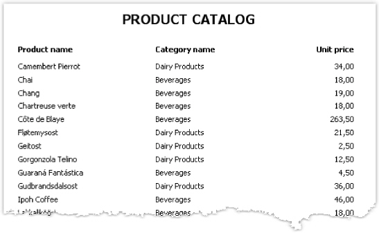

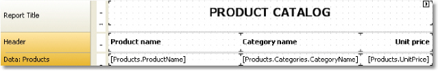

Let us look at the following report, which prints a products list:

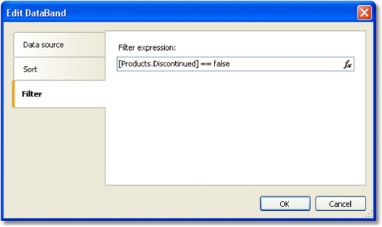

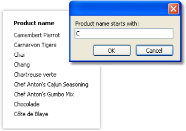

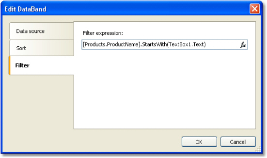

We will show in this example how to filter a products list according to the first letter of the product's name. During this, we will not use automatic data filtering facilities. For this, add a new dialog into the report and place two controls onto it - LabelControl and TextBoxControl:
Now open the "Data" band editor and indicate the following filter expression:
Run the report and make sure that everything works:

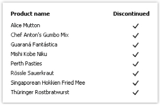

Example 6. Automatic filtering
In this example we will show how to add a filter into the report which prints a product's list from the "Products" table. We will filter the data according to the "Products.Discontinued" column.
The report looks as follows:
Add
a new dialogue into the report by pressing the
button
on the toolbar, and drag the "Products.Discontinued" column
from the "Data" window onto the dialogue form:
This is all we need to do - we did it just by two clicks. FastReport automatically connects the control to the data column.
Run the report and enable the Discontinued flag. After that, press the "OcyrillicKacyrillic" button, and you will see the report which contains only products with the Discontinued flag:

That is all we need to do, the rest of the work FastReport has done: connected the controls to the data column and set up their FilterOperation properties. The first control has got FilterOperation = GreaterThanOrEqual, the second - LessThanOrEqual.
Run the report and indicate the values, for example from 20 up to 30. When pressing the "OcyrillicKacyrillic" button, a report will be built. It contains products having values in the indicated range.

We will look at a "Simple list" report type, which prints products list. Category name is printed beside each product. This is done with the help of the relation:
The report will be as follows:
When we run the report, we will see the following:
Let us add filtering by category name. For this, add a new dialogue and drag the "Products. Categories.CategoryName" column onto it:
When creating control, you will be required to select its type. Choose CheckedListBoxControl. If we run the report, we will see the following dialogue:
Choose several categories and click the "OcyrillicKacyrillic" button. After this, the data will be filtered and you will see the following report:
As seen, only products have remained, which are in the chosen category.
