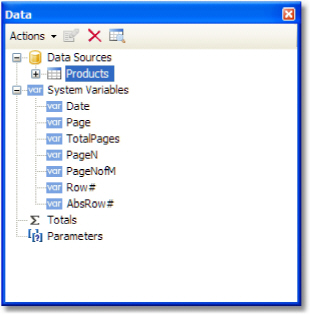

All data is accessible from the "Data" window. This window can be shown by choosing the "Data|Show Data Window" menu.
The "Data" window allows to operate with all data elements and also to drag them into the report page. All operations can be done with the help of the toolbar and "Action" menu:

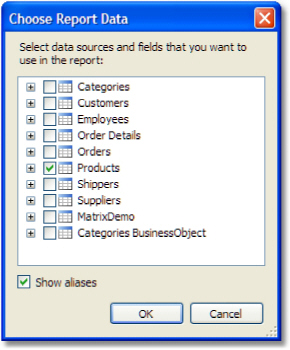

The first method - data source is defined in the application and registered in a report. It's up to the programmer who created this application (see details in the "Programmer's manual"). A user should only choose the needed data source in order to use it in a report. It can be done in the "Data|Choose Report Data..." menu.
All data registered in a report is listed in this window. Just tick off those data which are needed in your report. It can be done at any moment while working with a report.

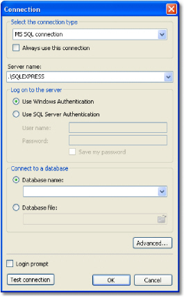

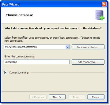

To create a new data source, choose the "Data|Add Data Source..." menu item or press the "Actions" button in "Data" window and choose the "New Data Source..." item. You will see the "Data Wizard" window:

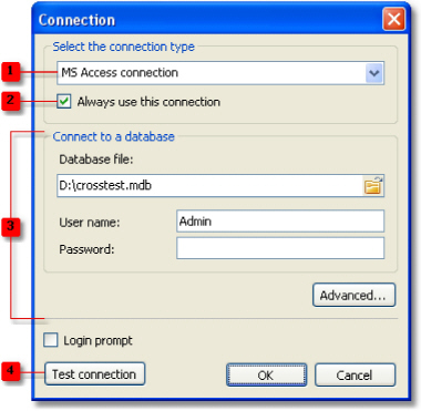

First of all, you are offered to create the connection. For that, press the "New connection..." button. You will see a window with connection settings:
The following elements are shown in the figure:
1.Connection type;
2.If enabled, the chosen connection type will be used by default.
3.Connection settings;
4.Test connection button
Connection with MS Access data base is shown in the picture. If another type of connection is chosen, then connection settings area (3) will be changed. For example, connection to MS SQL data base has the following settings:
Choose the needed connection type and set up its parameters. After pressing the OK button, the window will be closed and you will return to the data wizard window.
Next, you need to set a connection name. This name will appear in the "Data" window.

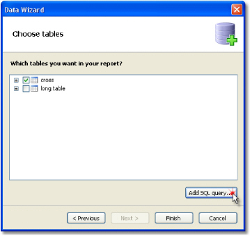

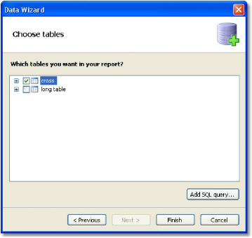

Press the "Next" button to continue. Here you will be offered to choose tables which are accessible in the data base:
Tick off the needed tables and close the wizard by pressing the "Finish" button. Now you can see in the "Data" window a connection created by you which contains the chosen data sources:
Data wizard allows quickly choosing tables, contained in a data base. Creation of SQL query requires additional work. For this, press the "Add SQL query..." button in the second step of the wizard.

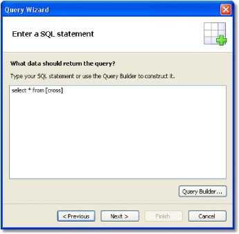

You will see the query wizard window. Query wizard has four pages. Use the "Next" and "Back" buttons to switch between the pages.
In the first step, you need to set the name of a query. This name will appear in the "Data" window. Enter any unique name and press the "Next" button.
In the second step, you have to enter a query in SQL language. Use the language dialect which is supported by your MSDB. You can use the query builder for visual query creation. To do this, press the "Query Builder" button. The query builder will be described in details later.
After you have entered the query text, press the "Next" button. In the third step, you can define the query parameters. It is required if your query has parameters. We will consider parameters later in this chapter.

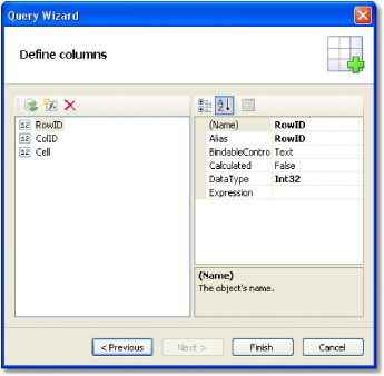

On the last step of the wizard, you can set up the columns which were returned by the query:
If you made a mistake in the query text or in the parameter definition, you will see error message when turning to the last page of the wizard.
As a rule, it is enough to be assured that the query has returned all the needed columns. On this step, you can do the following:
delete unnecessary columns using the "Delete" button;
reset the columns by pressing the "Refresh" button;
add a calculated column by pressing the "Add calculated column" button. For a new column, it is necessary to set the "Name", "DataType" and "Expression" properties.

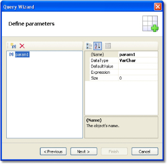

If your SQL query contains parameters, you have to declare them. It can be done in the third step of the "Query Wizard" which we have looked at above. To create a parameter, press the "Add parameter" button. A new parameter will be created:
The following parameter's properties should be set in the properties window:
Property |
Description |
Name |
Parameter name. Here you need to indicate the same name which you use in the query text. Some DBMS (for example, MS Access) do not support named parameters. In this case do not change this property. |
DataType |
Parameter data type. |
DefaultValue |
Value which will be used if the "Expression" property is not specified, or if it is impossible to calculate it (for example, when operating with the query in the report design mode). |
Expression |
Expression which returns parameter's value. This expression will be processed when you run the report. You can indicate any expression in this property (see details in the "Expressions" chapter). |
Size |
Parameter data size. This property should be indicated if the parameter is of "string" data type. |
If you set the parameter properties incorrectly, you will get an error when turning to the last page of the wizard.

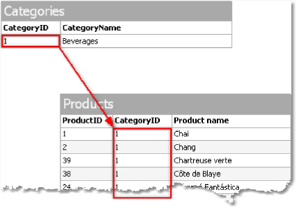

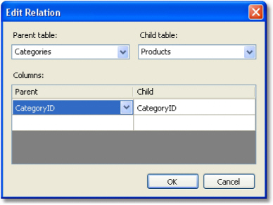

Between two data sources, a relation can be set. The relation is used to define the "master-detail" relationship. For example, one record in the "Categories" table can have multiple entries in the "Products" table:
In order to create a relation, you need to indicate the following:
Parent table;
Child table;
Set of key columns in the parent table;
Set of key columns in the child table.

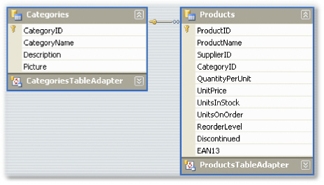

As an example, we will look at "Categories" and "Products" tables from the demo database. They have the following structure:
Both tables have got the CategoryID field, on which the relationship can be set. So, one category may contain several products.

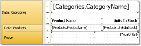

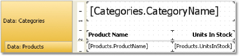

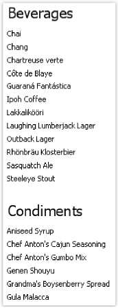

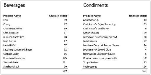

First method makes it possible to build reports of "master-detail" type. To do this, two "Data" bands are used. The master band is connected to the master data source, the detail band - to detail data source. Our example will be like this:

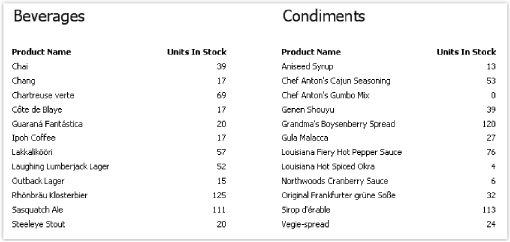

Such a report, if you run it, will print a list of products in every category:

To add such a data column into a report, open the "Products" table in the "Data" window. You will see that among its columns, there is a link to the "Categories" table:
If we drag the column shown above into the report, then we will get a "Text" object with a text:

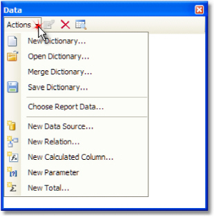

In order to create a relation, click the "Actions" button in the "Data" window, and select the "New relation..." item. You will see the relation editor:
In the first place, you need to choose the parent and the child tables. After this, in the lower part of the window, you need to choose related data columns. The tables can be related with the help of one or several data columns. After the columns have been set, close the relation editor by pressing the Ok button.
The relation that you've created can be seen in the "Data" window, if you choose the child data source and open a list of its columns. Among the columns, you will see the relationship with the parent source:
Parent source's data column can be inserted onto the report by using the drag&drop method. So, if we choose the columns shown in the figure, and drag it onto the report page, we will get a "Text" object with the following contents:
[Products.Categories.CategoryName]
In order to edit a relation, open the list of columns of the child data source, find the needed relation and click the "Edit... " button located on the toolbar. This will invoke the relation editor we have looked at earlier.

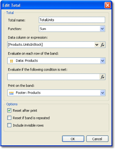

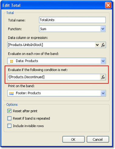

In many reports, we may need to show some total information: sum of the group, number of rows in the list, and many others. FastReport uses totals to perform this task. For the total, you need to indicate the following parameters:
The total function type;
The expression, which is supposed to be calculated. For the "Count" function, you do not need to indicate the expression;
The condition. The function will be calculated if the condition is met. It's not obligatory to set up the condition.
The data band, for which the function will be processed;
The band, in which the total value will be printed.

We will look at using the total function as an example. Let us create the "master-detail" report that uses two tables - "Categories" and "Products":
The prepared report will be as follows:
Let us add total in this report which will be printing the total quantity of units in stock for each category - sum of "UnitsInStock" data column. Total will be printed in the "Data Footer" band.
To print total value, you need to create it first. For this, press "Action" button in the "Data" window, and choose the "New total" item. Another method - right click the "Totals" element in data tree and choose "New total" menu item. You will see the total editor window.
First of all, you will be asked to indicate total's name. You will be referring to the total by its name, so name the total in such a way that it will be easy to understand as what it calculates. Let us call our total as "TotalUnits".
Then we choose the "Sum" function for the total.
Now we need to indicate data range for which total will be calculated. For that in "Evaluate on each row of the band:" field, we choose the "Data" band in which a list of products is printed. In the "Print on the band:" field we choose a band in which total will be printed - that is, the "Data Footer" band.
Close editor by pressing OK button. You will see the new total appears in the "Data" window. Now you can drag it into the report:
When we run the report, we will see the following:
In the previous example, total was calculated for all data rows. We can limit this range by indicating the condition in the total editor. Total will be calculated for only those rows, whose condition returns true.
For example, we can set the following conditions:
This will mean that, total should be calculated for those products, whose "Discontinued" flag is not set.

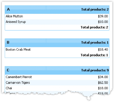

Let's look at how it works. Put the "Text" object which prints the total, on the group header. Set the "ProcessAt" property of the "Text" object to "GroupFinished":
When you run the report, FastReport will do the following:
it will print the group header. The total value will be printed as 0 (wrong), but FastReport will remember this object to process it later;
it will print all data rows;
it will print the group footer. At this moment, FastReport will take the object that was printed in the group header, and process it again to print the correct total value.
