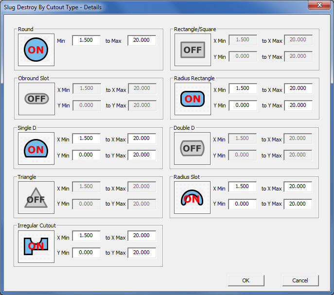

| Apply Based Upon Cutout Type and
Size
The user may select which pattern types and sizes Slug Destroy will be applied to. Select the option and then click the Details button to open the Slug Destroy by Cutout Type - Details window, shown here -
Irregular Cutout includes non-standard shapes and special tools. |
