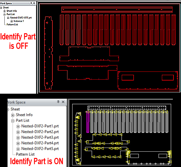

Nested or Multiple Part / DXF & NC files
When the DXF and NC Files are nested as multiple parts the behavior during importing will be dependant on the settings in the C:\AP100US\Parm\ Setting.ini file -
[LoadDxf]
BatchConvertVisible=0
IsAcorn=1
DxfPartHasECORevision=0
DxfPartHasRevDate=0
PreProcessDxf=1
CheckDxfIsSheet=1
IdentifySameParts=1
When Identify Parts is switched OFF the program sees this sheet as one part (Notice Instance 1), but in the below image Identify Parts is ON and the parts are seen as separate instances.

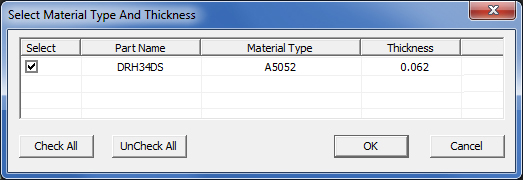

Material Type & Thickness Check
If the user attempts to open a part with a material type and/or thickness that differs from the material in use on the current sheet, the Select Material Type and Thickness dialog will automatically open. The user must then select the current material type by checking ON the check box for the similar material (forcing the part to use the currently loaded sheet material). If the user does not check ON the material type, AP100US will not allow that part to be added to the sheet.

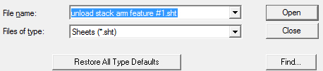

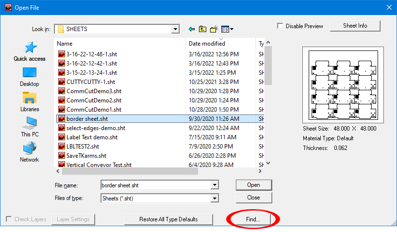

Filtering Sheets, Parts & Tools
To search for a Sheet file, click the Find button circled here in red
when "Sheets (*sht)" is chosen in the Files of type field

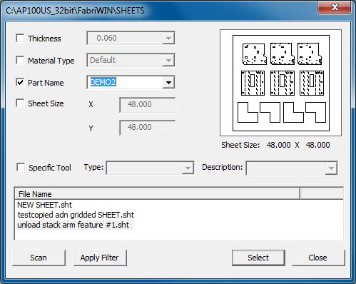

In the Find window that displays next, the Part Name filter has been checked to
enable the display to list only those sheets that contain the "DEMO2" part
How the Filtering Process Works
To begin, click  to have the program examine the characteristics of all files in the selected folder and populate the checkbox fields. Then check the box next to the desired filter type(s), such as Part Name to activate that field and click the drop-down arrow to select a specific part to become the search criterion (such as "DEMO2" as shown above).
Since only Part Name>DEMO2 was selected, the filter will look for DEMO2.PRT in all of the sheets in this folder. If that part is present in a sheet, it will display in the File Name view.
Now click  to allow the system to filter out files that do not meet the search criteria.
Note: The user may check multiple filters at once.
The search results returned three sheets that contains the DEMO2 part. Select a sheet in the File Name view, click the Select button and the search window will close.
The selected sheet now appears in the File name field of the Open File window as shown here -
Click Open to place the sheet in the AP100US work area. The user may also use this same approach to batch select parts.
Note: Sheets that contain the selected part may contain other part files as well.

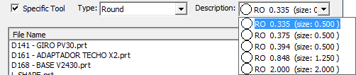

Search for Parts using a Specific Tool
To search for parts according to the part info saved with the tool, begin by selecting the Parts (*.prt) option from the Files of Type drop-down. Check the Specific Tool checkbox, specify the tool Type and Description. Hit the Apply Filter button and parts that use that tool appear in the File Name list.
Note: This option is not available for Sheet search.
Standard and Special Tools may be searched

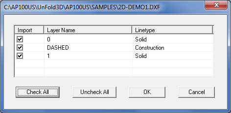

Check Layers
The Check Layers option in the Open File dialog box becomes available whenever the user selects *.dxf or *.dwg file types from the Files of type: list. Check this box and click the Layer Settings button and when the software starts the importation process, the Select Layers dialog appears -
Place a check mark in the check box next to a layer name that you want to import. Remove the check mark from the check box next to a layer name that you want the system to ignore.
For example, a file may have a Pattern Layer and a Dimension Layer. To import the Pattern Layer only, place a check mark in the Pattern Layer check box and remove the check mark from the Dimension Layer check box.
In the Linetype column, toggle the choices between “solid” and “construction.”
Click OK to continue or Cancel to exit. Click Check All to place check marks in all the check boxes. Click Clear All to remove all the check marks.
